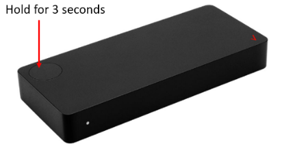

Pairing from the button
1) Press and hold the top button for 3 seconds to put the Stream TV into pairing mode.
Hold the button the device for 3 seconds

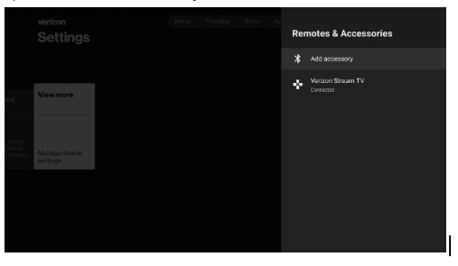

Pairing from Stream TV Home screen
1) From the Stream TV Home screen, select the Settings menu in the upper-right corner.
2) Scroll to the right to select “View more”
3) Select Remote & Accessories.
4) Select “Add accessory”.
5) Press and hold the “Play\Pause” and “0” buttons on the remote control simultaneously for 6 seconds.
6) Release the buttons to enter pairing mode.

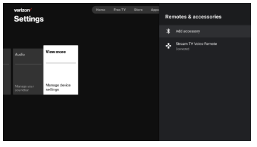

Pairing from Stream TV Soundbar Home screen

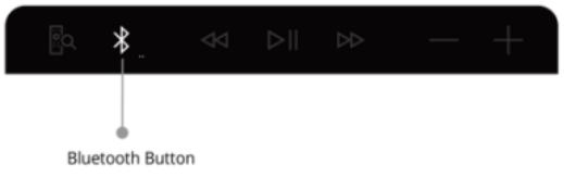

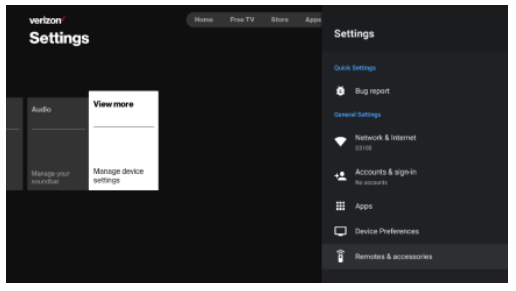

Pairing from Bluetooth button
1) Press and hold the Bluetooth icon on the touch panel for 1 second to put the Stream TV Soundbar Pro into pairing mode.
2) When prompted on your TV, press and hold the “Play\Pause” and “0” buttons on the remote control simultaneously for 6 seconds.
3) Release the buttons to enter pairing mode.
