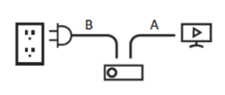

The following instructions can also be used for setup
1. Connect the HDMI cable from the Fios TV+ to your TV.
2. Connect the Fios TV+’s power adapter and plug it into a power outlet.
3. Turn on your TV, set the TV to the correct HDMI input and follow the on-screen instructions to complete activation.
4. Repeat this setup for each additional Fios TV+.

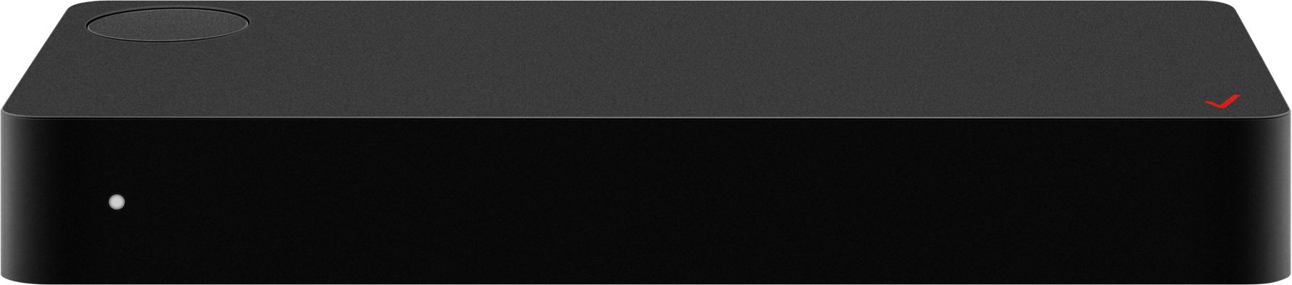

Fios TV+ technical information
SKU numbers F3544K49203SC, SIP03ASK, STI6221 Colors & size Color: gray or black
Size: 150mm W x 64mm D x 22mm H
Refer to the following images for size details.Mount bracket
Refer to the following images for mounting information. Input & Output
HDMI2.1a with HDCP2.2 for video, USB-C 3.0 for power.
Refer to the following image for connectivity details.Processor
Realtek RTD1319 Operating system Android TV 11 or later Capacity 4GB DRAM, 16 GB flash Bluetooth Protocol BT5 or higher with BLE WiFi protocol 802.11ax wireless 5.0 GHz Power 5V, 2 Amps Compatibility It’s compatible with all HDMI-compliant TVs Video formats

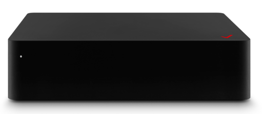

VMS technical information
SKU numbers
VMS4100ATV Size and Weight Size: 231.2mm W x 189.5mm D x 53.4mm H
Weight: 0.968 kg
Refer to the following images for size details.Input & Output

Fios TV+ DVR
We’re here to help you set up the Fios TV+ DVR and answer other questions you may have.
Please note: The Fios TV+ DVR needs a Verizon router to work, please make sure you have a Verizon router set up and working.
First-time setup
Get the My Verizon app for more support.
Scan the QR code or download it from the appropriate store.
What's in the box?
- Fios TV+ DVR (1)
- Ethernet Cable (1)
- Power adapter (1)
If you’re missing any of these items, please chat with us.Setup Video
This video will show you how to set up the Video Media Server. Or check out the following step-by-step guide.
Key moments in the video:
- Set up router in the same room as the ONT - 01:12:00
- Set up router in a different room as the ONT - 01:56:00
- Connect Fios TV+ DVR to your router and power on - 02:36:00
- Set up Fios TV+ with remote and on your TV - 03:52:00
- Additional setup: Mount your Fios TV+ or set up your verizon stream TV - 04:57:00
1. Choose a setup location.
Choose a setup location next to the router with a power outlet nearby.
2. Connect the ethernet cable.
Connect the ethernet cable to the ethernet port on the Fios TV+ DVR and the LAN port on your router.
3. Connect the DVR power adapter and plug it into a power outlet.
Follow the diagram on the right that shows the wired connection required to set up your Fios TV+ DVR.

Network diagram
This diagram displays how the device should connect to your TV and router.
Fios TV+ DVR technical information
SKU numbers
J7SE Size and Weight 170mmW x 140mm D x 50.75mm H

Input & Output
Refer to the following images for connectivity details. LED Indications
1. LED off
Fios TV+ has no power. 2. LED blinks once
Fios TV+ reacting to any successful button-push. 3. Solid white
All network connections are complete.
4. Dim solid white
TV is connected, but turned off (standby mode). 5. Soft pulsing white (every 1 second)
System is turning on. 6. Fast blinking white (every 0.2 seconds)
Software is updating. 7.
Slow blinking blue (every 0.8 seconds)
Fios TV+ is paring to a remote control. 8. Fast blinking blue (every 0.2 seconds)
“Find my remote” is activated. 9.
Solid yellow
Fios TV+ isn't connected to the internet 10. Fast blinking yellow (every 0.2 seconds)
Factory reset has been initiated. 11. Solid red
Fios TV+ isn’t connected to a display or remote control. 12. Blinking red (every 0.8 seconds)
Fios TV+ error 13. Blinks red 3 times and turns off
Fios TV+ is overheating.
